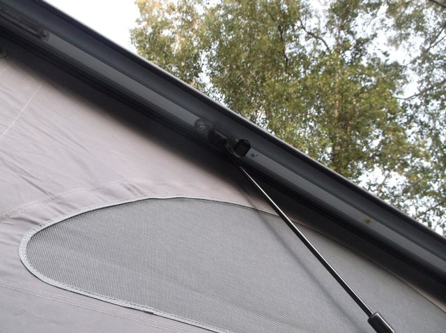

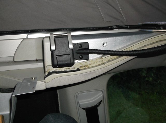

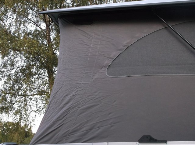

My manual Cali roof after the hydraulic system broke down. Made by myself.
